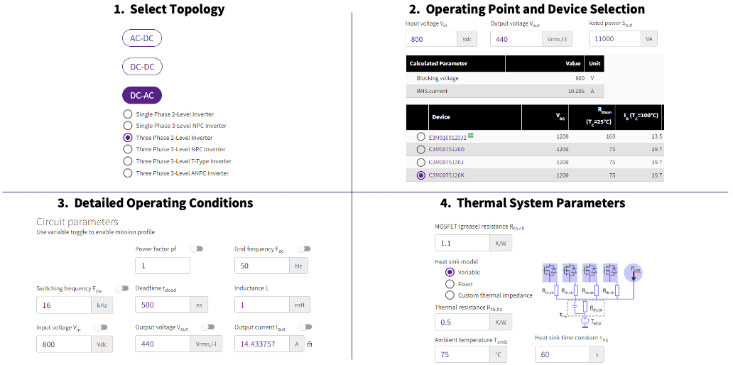

    Simulators provide a quick and reliable way to explore system needs and how SiC devices will perform within them and provide an ideal platform for designers to model systems, determine the correct voltage class or power need for an application and aide in selecting the most applicable devices for further testing.
    Wolfspeed’s SpeedFit® Design Simulator is an online PLECS-based simulation tool that offers an easy-to-use interface for evaluating silicon carbide MOSFETs, diodes and power modules.
    SpeedFit offers more than 35 topologies, including several three-phase inverter topologies. To get started, specify basic operating points for the desired application and choose from a recommended list of silicon carbide products. Then, input detailed circuit parameters, operating conditions, and thermal parameters dependent on the topology. Transient operating points may be enabled to see the effect of overload conditions on the thermal performance. SpeedFit offers flexibility in the thermal system configuration, allowing thermal parameters to be inserted as a fixed heatsink temperature, or as a thermal impedance to ambient. If the end thermal system is unknown, this step can be used to determine the thermal requirements of the system.
    An example of desired parameters for an 11 kW motor drive for a heat pump application and the SpeedFit simulator input can be seen in Figure 1.

    Once parameters are entered, the simulation can be run to determine results within seconds. Results include waveforms to determine how the converter is operating, junction temperature, power loss and efficiency. From here, the result can be held while adjusting previous inputs.  This allows easy comparison between the performance of different parts under different operating conditions and identifies the best MOSFETs or power modules for the system requirements. Save simulation results as a PDF or CSV, or request samples directly to begin the evaluation stage.

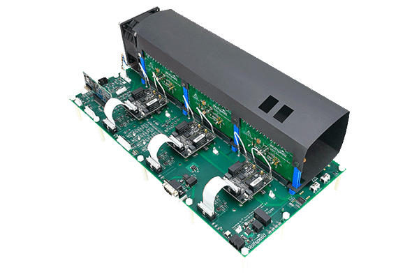

    Evaluation kits like the SpeedVal® Kit Modular Evaluation Platform allow rapid testing of specific silicon carbide discrete devices in three-phase motor drive systems. The SpeedVal Kit, which was created specifically for three-phase motor drive applications, offers a modular set of building blocks that can be easily swapped for rapid in-circuit evaluation of system performance at real operating points.
    Fig. 2: SpeedVal® Kit Modular Evaluation Platform​ Three-Phase Motherboard
    Use SpeedVal Kit to evaluate and optimize the high-speed dynamic switching performance of Wolfspeed’s 650 V to 1200 V SiC MOSFETs paired with your choice of gate drivers from industry-leading partners. The three-phase motherboard includes open loop firmware for testing devices on static loads and provides a platform for advanced control and firmware development for motor control.  Also included are hardware interfaces for both encoders and resolvers to support closed loop speed and position control.
    SpeedVal Kit also allows for dynamic testing, including double-pulse and short-circuit tests. These platforms are built to have optimized test points to allow high-fidelity current and voltage readings. With these readings in mind designers then tune the dV/dt, a critical parameter in motor drive applications to ensure compatibility with existing motors and adjust gate resistance and gate capacitance to tune switching behavior.  Together, optimized dV/dt and gate resistance further solidifies the powertrain design and streamlines the final development stage.
